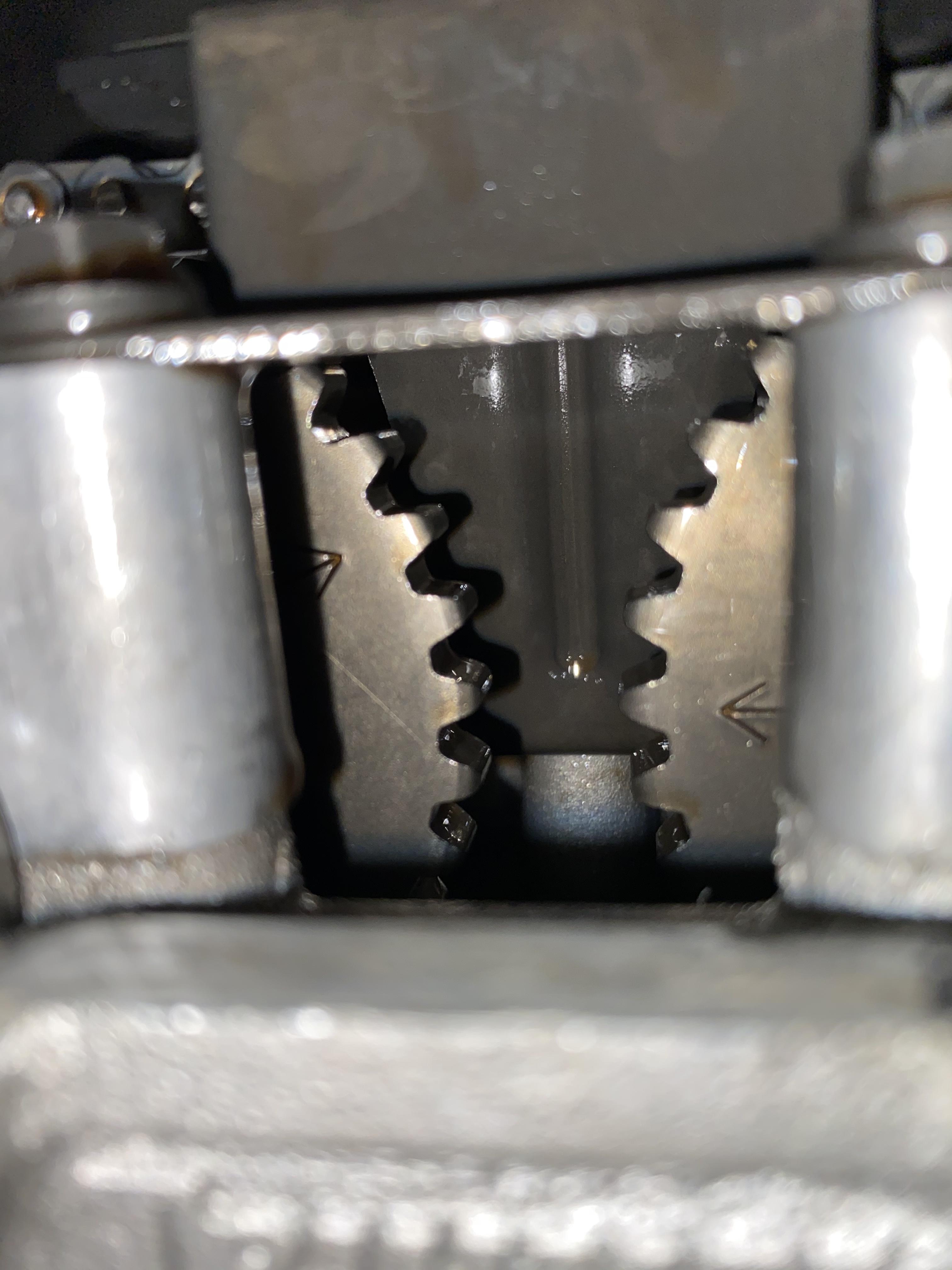

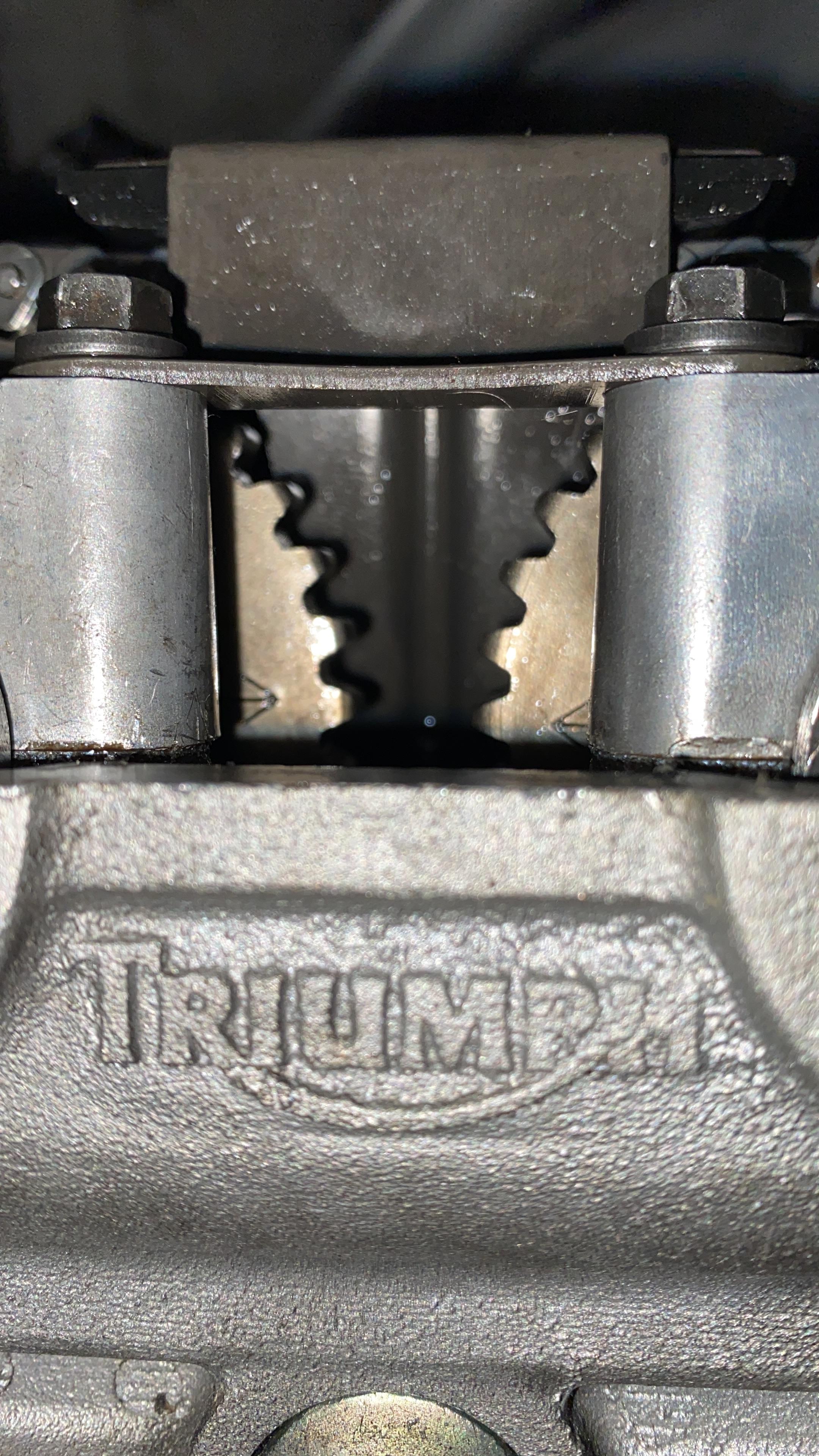

Andre95 0 Posted December 16, 2020 Author Report Share Posted December 16, 2020 Vielen Dank für die Beiträge 🙋♂️ habe mal neu eingestellt und den Motor 4 Umdrehungen gedreht wie im Werkstatt Handbuch beschrieben. Quote Link to post Share on other sites
Andre95 0 Posted December 16, 2020 Author Report Share Posted December 16, 2020 Quote Link to post Share on other sites
Tuebinger 7 Posted December 16, 2020 Report Share Posted December 16, 2020 Volltreffer - bin auf das Endergebnis gespannt... Gruß vom T. Quote Link to post Share on other sites
