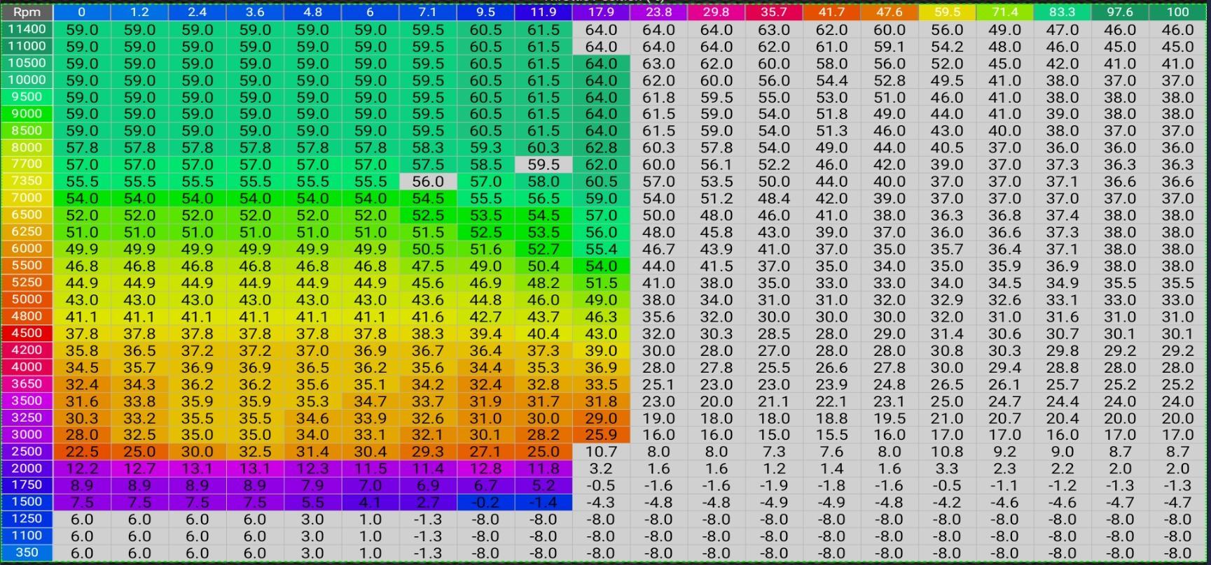

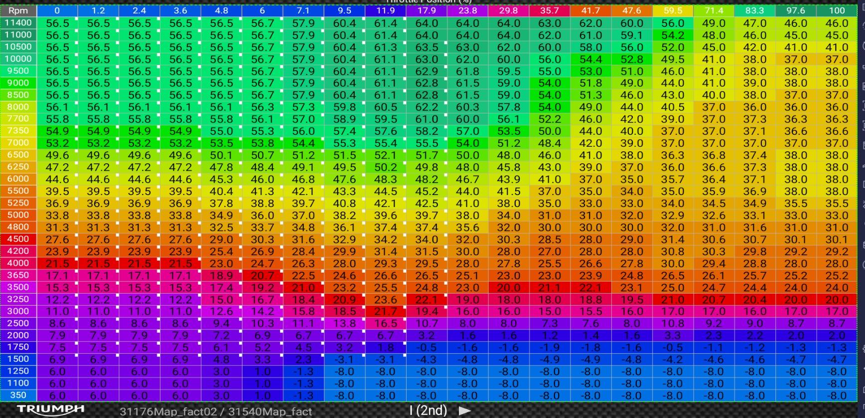

Racer9 Geschrieben 16. April 2024 report Geschrieben 16. April 2024 vor 11 Stunden schrieb Amerigo: hast mal einen Link dazu, bitte? Gruss Amerigo Recall Campaign - Engine Timing Most of us are aware of the current recall affecting the 1200. It was understood early on that the recall was to address engine timing to prevent an overheat of the fan motor. The overheat is a result of the proximity of the fan motor to exhaust headers. It was thought that engine timing was going to be retarded to reduce engine temps, thus reducing power. This turns out to NOT be the case. I made several posts myself about an expected power loss. It turns out the updated map advances timing. Attached are images of ignition timing for 2nd gear. The first image shows the changes in the updated map (31540) and the second image is the original map (31176). Most cells show several degrees of advance. This makes sense in hindsight. Advancing timing increases engine temperature but reduces exhaust temperature which was Triumph's goal. Timing was advanced in 2nd and 3rd and to a lesser degree 4th. 1st and 6th were untouched. In addition to the timing changes, throttle curves were remapped to be more aggressive and a bit of fuel was added to the L tables. All in all this should be a positive improvement to performance. Rückruf-Kampagne - Timing des Motors Die meisten von uns wissen, dass der aktuelle Rückruf die 1200 betrifft. Schon früh wurde verstanden, dass der Rückruf dazu diente, das Motortiming zu behandeln, um eine Überhitzung des Ventilatormotor Die Überhitze ist eine Folge der Nähe des Ventilatormotors zu den Auspuffkörpern. Man dachte, dass das Timing des Motors verzögern würde, um die Motortemperaturen zu reduzieren und so die Leistung zu verringern. Das stellt sich heraus, dass es NICHT der Fall ist. Ich habe selbst mehrere Beiträge über einen erwarteten Stromverlust gemacht. Es stellt sich heraus, dass die aktualisierte Karte das Timing verbessert. Anbei Bilder von Zündzeitung für den 2. Gang. Das erste Bild zeigt die Änderungen in der aktualisierten Karte (31540) und das zweite Bild ist die Originalkarte (31176). Die meisten Zellen weisen mehrere Grad des Fortschritts auf. Im Nachhinein macht das Sinn. Das Vorwärts Timing erhöht die Motortemperatur, reduziert aber die Abgastemperatur, was Triumphs Ziel war. Das Timing wurde in der 2. und 3. und in einem geringeren Grad 4. vorgezogen. 1. und 6. waren unberührt. Neben den Zeitwechsel wurden Drosselkurven umgedreht, um aggressiver zu sein und ein bisschen Treibstoff in die L-Tabelle zugesetzt. Alles in allem sollte dies eine positive Leistungssteigerung sein. Reifenfresser, platoon964, Smutje und 1 Weiterer reagierten darauf 4 Zitieren
Racer9 Geschrieben 16. April 2024 report Geschrieben 16. April 2024 Reifenfresser, Andi702 und adryanh reagierten darauf 3 Zitieren
